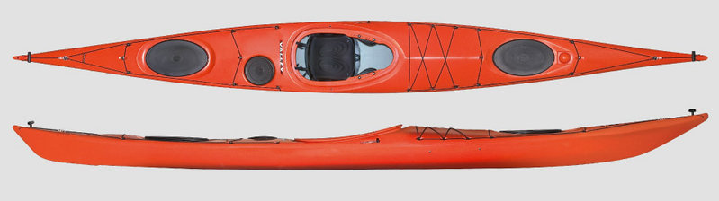

Valley Etain 17.5 RM.

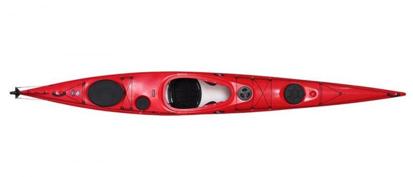

Seabird Victory HV.
